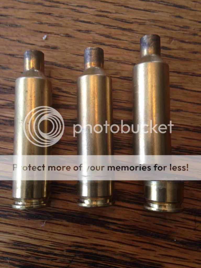

If the case is not held against the bolt face for the first shot, then it will stretch and is on the way to a head separation that can not be reversed. It is a BIG problem with Ackleys that do not have enough crush

"Crush fit" is not the same as "jam". AI's must be chambered shorter than the parent cartridge to prevent case separations. The usual recommendation for the 22/250AI is -0.004" shorter than a standard 22/250 Rem. This is usually accomplished during chambering by using the standard 22/250 Rem "go gage" as the "no go" gage and using a 22/250AI "go gage". Actually I prefer a even slightly shorter chamber than -0.004" to ensure a tight crush fit on new cases. When the proper chamber length is used, jamming the bullets is not required at all. I use near max standard 22/250 Rem loads for fire forming. Vic
I know the difference between a crush fit and a jam. I was relating that a jam has worked best for me. A crush fit is necessary so you don't end up with the separations I pictured. Sorry for the confusion

0.004" of crush is not adequate - that is where the head separations come from.
When Nosler tried to get the 280 AI standardized and accepted by SAAMI, SAAMI kicked it back with a "Bad Engineering practice" remark... they required a minimum of 20 thou of crush.
Most gunsmiths are too cheap to get a set of AI gauges - they just use the no-go as a go, and grab the money and run.
