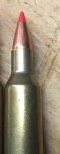

I have a bunch of 22-250 loaded rounds that the Vmax is seated too deep. Just got Impact Hammer this afternoon. I knocked the heck out of the hammer on the side of a concrete wall. After thinking I was going to break the tool and also my arm. I dececied to seat the bullet a little deeper to break the case-bullet bond.. This seemed to help.
Any ideas or suggestions to make this process easier?
I want to keep bullet in case and just reseat it,
I have a collet puller also. The dang bullet is seated so deep hard to grip bullet. The one on the right is how they are seated now and left was where it got slapped a few times. A36F7894-72A2-4718-92E4-5091771E1485.jpeg

Did you look at the cartridge after seating the first one, as you sure buried it?
Is that blood on the bench?

I have a collet puller also. The dang bullet is seated so deep hard to grip bullet. The one on the right is how they are seated now and left was where it got slapped a few times. View attachment 1338176
Instead of using that phony collet that comes with the hammer use a shell holder with the hammer it’s much faster. Seating further as you have found can help. Hammer straight down on something very solid not a wall. You can do it I’ve done a lot of them.

Mark T, the Hammer is the only way for you to go as you do not have enough bullet shank exposed to get a bite on with the Grip and PULL or a collet puller.
You may have to get down on your knees in the garage, hammer straight down so that the head of the hammer is perpendicular with the floor, this is critical.
I have put cotton in the head to catch the bullet so as the tip deforms less. You may get lucky and determine how much force is needed to pull the bullet out "some" but not all the way, then seat the bullet to your desired length.
