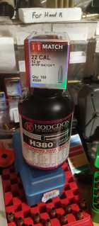

image_cropper_1759800111719.jpgimage_cropper_1759944635337.jpgimage_cropper_1762468151073.jpg
I mean my velocity wasn't bad with 2460 ..just didn't Wanna group and also I don't wanna use these super light varmint bullets for the most part
And not gonna lie I'm pretty happy with my current load even though it's about .223 velocity...but I'm getting. Sick of hearing " well my 22-250 runs the same bullet at 3700fps " " why hay a .22-250 when you just going that fast " yadda yadda yadda so I'm just trying to find something to get it fast to shut people up
In 3 different 22/250 varmint barreled rifles that I have used H-380 with a 52 gr bullet was a great powder/bullet combo. JME
Yeah I was gonna try that H380 actually bought some but I don't see any data in the hornady app so I don't touch it
Thought this stuff was better for 55 gr bullets ?
I would start at 36 grs and work up. In one rifle the 53 gr Sierra M shot great with somewhere around 36.5 grs. In another the bullet was the 52 gr Berger with 38.4 gr of H-380 . The Hogdon site gives , I believe 41grs as a max load with 52/53 gr bullets.
