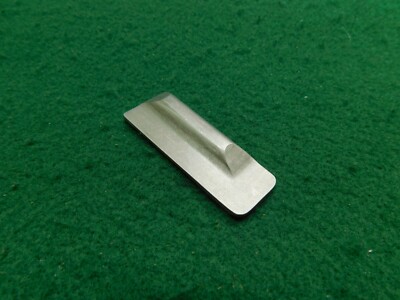

Try putting the spacer back in and get a Ruger M-77 follower for a 22-250, You may have to shape it to fit, It may work for you. Also make sure the chamber has a small chamfer on it, Sometimes that will cause a hang up. And check the extractor fit.

Sounds like the feed rails may be too wide, But I would try that follower and a spacer. I am familiar with the 1917, The pic I put up was of a 98 Mauser T-Guard with a spacer installed, You can glue in a peice of Delrin instead of welding one in also.
Thanks. I will give that a try and thanks for finding that follower!
I was able to get this to feed by milling a mauser 98 follower to fit and using a strong spring. I left it as a full length and did not put a spacer in.
