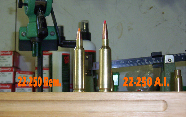

can someone post a pic of a 22-250AI cartridge? Has anyone here ever shot a 22-250AI in competition? I would think a 22BR would be a better choice if competition was the order? Lee
Something like this?
or

And thats a sweet looking case 2644ever! Is that a Cutting Edge bullet?
