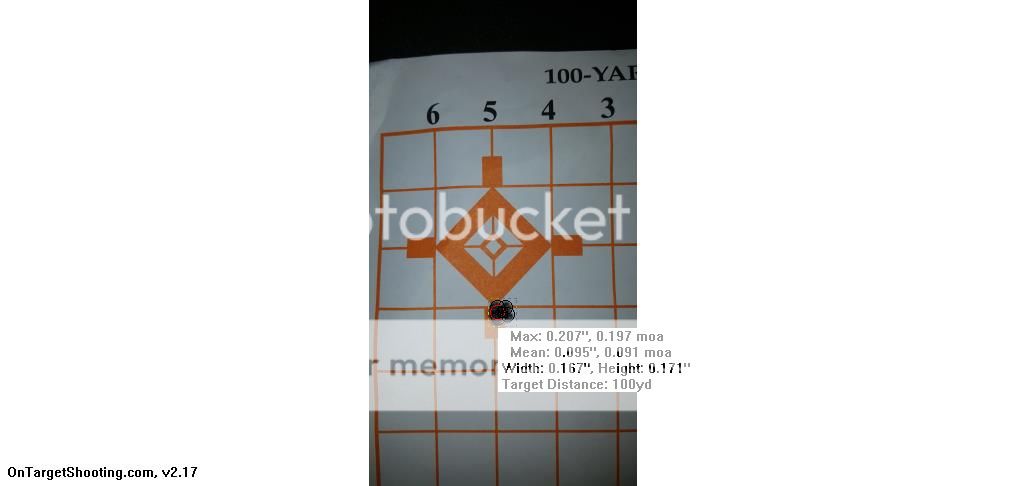

If the shots don't go in the same damn hole as the first.......then I call 'em fliers........different expectations of accuracy.....Wwaaayyyy different....night and day different.:(
yep. this or better is what all this is about for me
