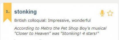

Laurie said:
Scotland's Paul Crosbie, (whom you'll remember from Blair Atholl in 2011) is the reigning GB F/TR league champion and while he probably shoots 155.5s more often than anything else, has had some stonking results from the 200gn Berger Hybrid.
[br]
Learn something new every day. :)

Steve,
I don't know if it's pure coincidence or there's a direct link, but 'stonk' as both noun and verb was a British Army term for a particularly heavy artillery barrage or the laying of one such on - used for both 'outgoing' and 'incoming'. It was very widely used in WW2, maybe the Great War too, so maybe the subjective experience gained of laying down a particularly impressive amount of HE (or lying in a trench while receiving it) transferred into civilian colloquial usage as something that's effective and devastating.
(What was it George Bernard Shaw wrote? America and Britain are two countries divided by a common language. I should have remembered that this word might have no meaning to most people on this forum, so thanks for putting the explanation up.) :)
