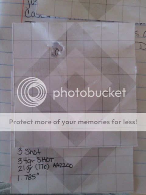

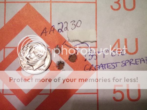

Lets see.... hmmm. wrong. I shoot the 34 gr Midsouth Varmint Extreme Nightmare bullets in my .204 Ruger and my 20 Vartarg. They are the Midway Dogtown bullet in all appearances but only cost $40 per 500 from Midsouth Shooter Supply. The pics below speak for themselves.
10 shots, rapid fire with no barrel cooling time whatsoever from my 20 VT using a bipod off the tailgate of my truck. I pulled a couple shots from a not-so-steady rest and still managed this 10 shot group.

3 shot group with a different charge of same powder
Another 3 shot group with same bullet in a whole different powder
And another powder with 3 shots

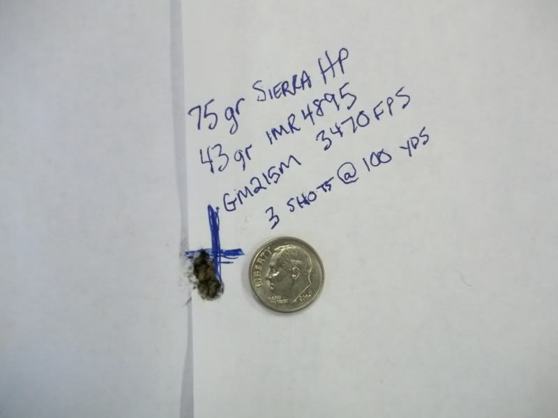

I also use the 75gr Sierra HP Varminter Bullets in my factory heavy barrel Ruger M77 6mm Remington. I know this is all kinda off the subject, but just for fun, here's a pic of what those Sierras do for me in a 100% factory rifle of old. The rifle is 34 years old to be exact :)
