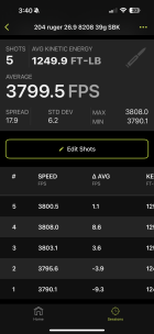

I have a 204r shooting 8208 and 39sbk. It’s a cz 527 with a pac nor barrel. I took charges up to 28.1 pushing 3998fps.
I settled on load of 26.9 as I felt that one gave me best group. Had another at the upper end but don’t need to run it that fast

It’s 24” and think I tested charges up to what you have around 28.3. I got a good group but I didn’t need to push it that hard. As someone said a p dog won’t know difference between 3800 and 3900fps.
Here is what I had for 28.1
