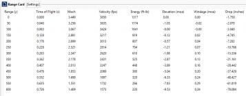

Just an easy question for you guys who are shooting a 204 ruger, 100yd zero what are your drops at 200 and 300 yards ? I checked my drops today and was amazed and a little bit puzzled at the same time. I’m shooting a 39gr bk at 3850. Thanks to those who chime in.
The Sierra 39 isn't part of the Applied Ballistics library, so that code doesn't have the Applied Ballistics BC values or radar tracks. However, the Sierra code would of course have this and I ran it for you. FWIW
ETA: Noticed it didn't update to your 1.75" scope height, so I re-ran and corrected it since I noticed you are really zooming down on the elevation issues.
Thank you for that. It’s showing a 2 minute drop to 300. Which is all over what I had shot just 3 months ago.
Where did you get this particular ballistic table. ?
RegionRats data shows the BIG difference between a true 100 yard zero with a high velocity cartridge (204R) and what most shooters see when group centers are 0.5-1.0 inches high at 100 yards.
Yes, the run is for the requested velocity, scope height, and I assumed at least enough twist to be stable and no cross wind, at sea level. And to your point, a true 100 yard zero.
Give me a minute and I will run the 40 VMax using the AB program for the same inputs, give it a 100 yard zero.
Is that the correct drop in inches at 300 yards, or am I misinterpreting something incorrectly?
Come-up inches from 100 is different than the drop as AB shows it.
In the elevation MOA column 1.98 MOA at 300 yards.
So for a 100 yard zero then the come-up in inches at 300 yards would be 1.047x1.98 x 3 = 6.2"
