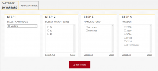

Availability is the main problem these days and the Hodgdon web site is showing only Ramshot and Accurate powders, but not traditional Hodgdon powders. Here is what they are showing, and supposedly these are available. I tried LT-30 and LT-32 once upon a time, and they showed promise but I never ran a lot of them.
