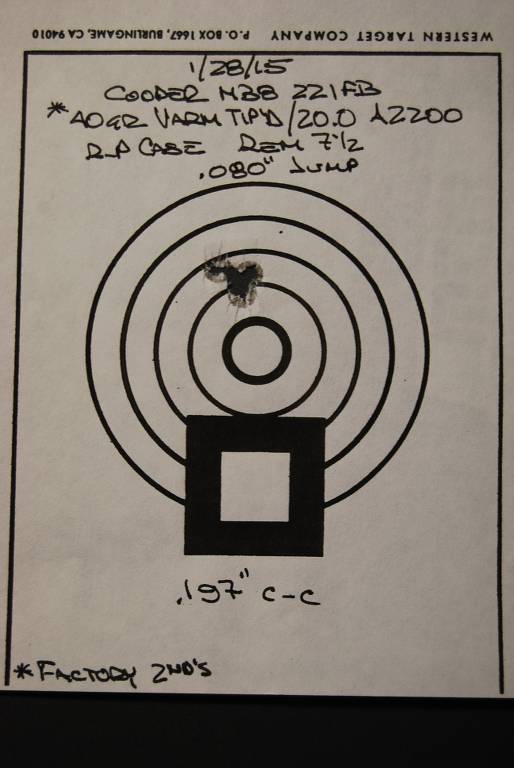

I have both the 20VT and 221FB, and for what you describe you want the rifle for, I'd go with the Furball for the reasons already mentioned. I varmint hunt with both mine, and for that pursuit, I prefer the 20VT for it's faster velocity/flatter trajectory. But as you already know, the .224" bullet selection is better than .204", so the 221 may be a better choice for you.
As far as accuracy in both/either:
Both targets shot with Nosler seconds from my BR Pivot portable bench.
Ya know Rick your FB really doesn't appear to shoot very well at all, heck, in five shots you couldn't even hit the bullseye one time. Tell ya what, I'm feeling overly generous today so I'll give you five hundred bucks for that 221FB of yours so you don't have to be so embarrassed in owning something that clearly shoots so poorly. I don't know you but it pains me to see even a stranger suffer throw life owning a rifle that obviously shoots horribly. ;)
All joking aside, for the rest of my life if I never shot a group that was any worse than any of those three I'm pretty sure I could live with that. Nice chootin.
