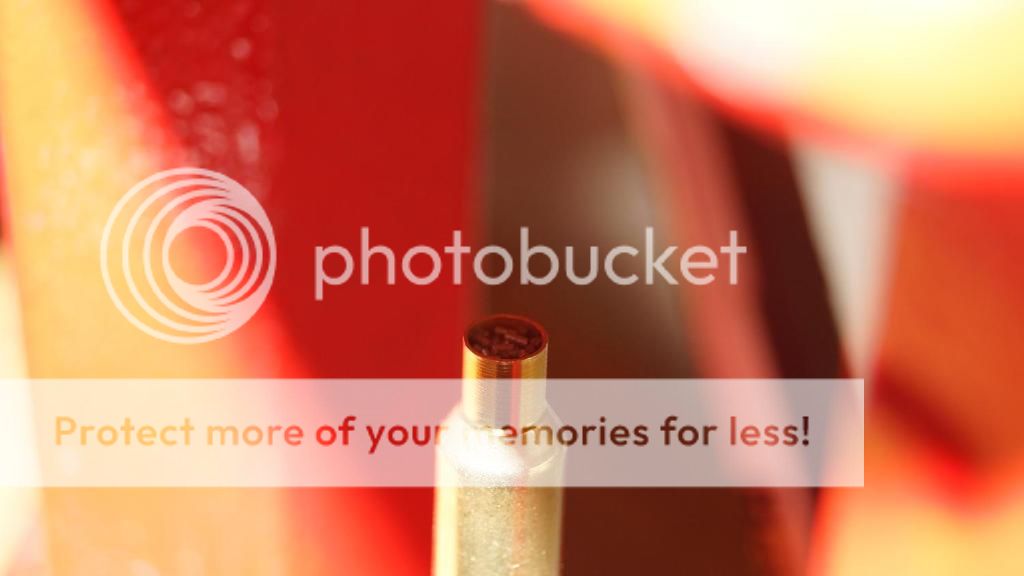

This photo represents the consumed case volume with H4198 and a 40gr bullet, I can't fit enough powder in the case to do any damage.

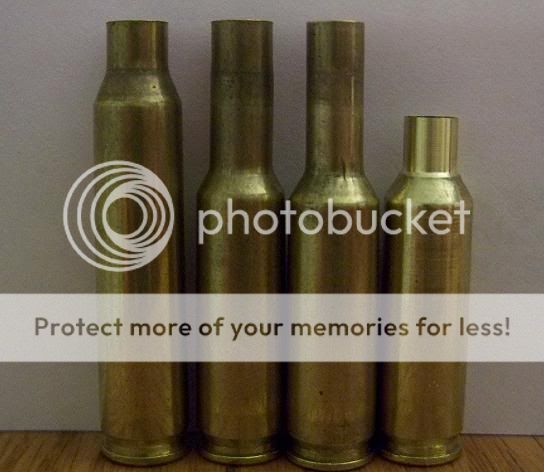

This is the process in which a LC cases is reformed into a 20VT.

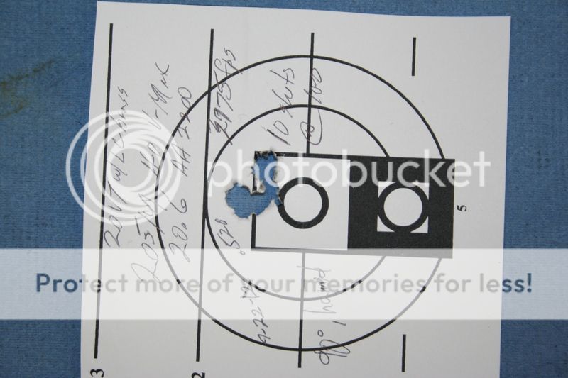

THose targets above are from a barrel with over 2,000rds down it. Also the 34gr Dogtowns love to be seated way off the lands, mine are seated .070" off the lands. Adam
