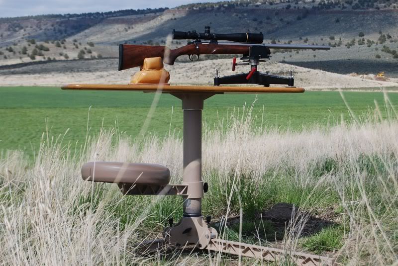

Steve: Thanks bud....had her out for four days last week shooting ground squirrels.....went 200 rounds without cleaning, no loss of field accuracy, as squirrels still launched upwards at ranges that stretched 400 yards; a very good time with the little rig and the RL-7/32gr Nosler BT load at 3,700 fps (squirrels really hate it).
The accuracy of this little round, plus the efficiency still amazes me. Here's a shot of "Scooter" as she's affectionately called, on the bench at teardown at the end of a grand day in the field:
Good luck with yours! :)
"Squirrels really hate it." ;D That's an understatement, Rick. They "bust a gut" every time they run into one of those Noslers or V-maxes. BTW, your rifle looks like an exact copy of mine, even down to what appears to be a 6.5 x 20 Leupold Vari-X III scope.
BTW, I like the look of the rotating portable rest. What brand is it, and the approximate cost? Is it made of aluminum for easier transport?
