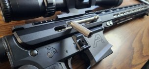

@cb186 I see the cutout and a side charger style handle.
Can you explain a little more?
Also, is your set-up compatible with a brass catcher that mounts on the gun, or do you use something else?
