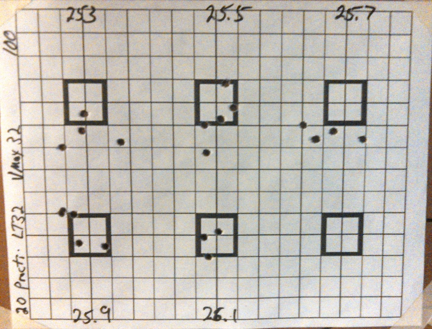

I haven't finished my testing with lt32 but here is some chrono data from my test. not quite at max yet and a node was starting at 26.1 so i am going to retest with 26.3 through 26.7 to see what happens.
Code:
25.3gn lt32 32vmax
	  1)	3937
	  2)	3964
	  3)	4000
	  4)	3986
		 High:	4000
		  Low:	3937
		 E.S.:	63
		 Ave.:	3971.8
		 S.D.:	23.8
25.5gn lt32 32vmax
	  1)	4045
	  2)	4008
	  3)	4012
	  4)	4029
	  5)	3990
		 High:	4045
		  Low:	3990
		 E.S.:	55
		 Ave.:	4016.8
		 S.D.:	18.8
25.7gn lt32 32vmax
	  1)	4082
	  2)	4076
	  3)	3982
	  4)	4045
	  5)	3996
		 High:	4082
		  Low:	3982
		 E.S.:	100
		 Ave.:	4036.2
		 S.D.:	40.8
25.9gn lt32 32vmax
	  1)	4072
	  2)	4098
	  3)	4052
	  4)	4116
	  5)	4106
		 High:	4116
		  Low:	4052
		 E.S.:	64
		 Ave.:	4088.8
		 S.D.:	23.5
26.1gn lt32 32vmax
	  1)	4131
	  2)	4018
	  3)	4118
		 High:	4131
		  Low:	4018
		 E.S.:	113
		 Ave.:	4089
		 S.D.:	50.5

Wow
LT can deliver the velocity. One of the things I wondered about.
I have had two 20P sold the first built another. They both grouped better in the 3900 fps node. You might try a lower node to see what happens
Thanks for sharing your information with us
Tim
Thanks i had a node in the 23gn area i will revist it.

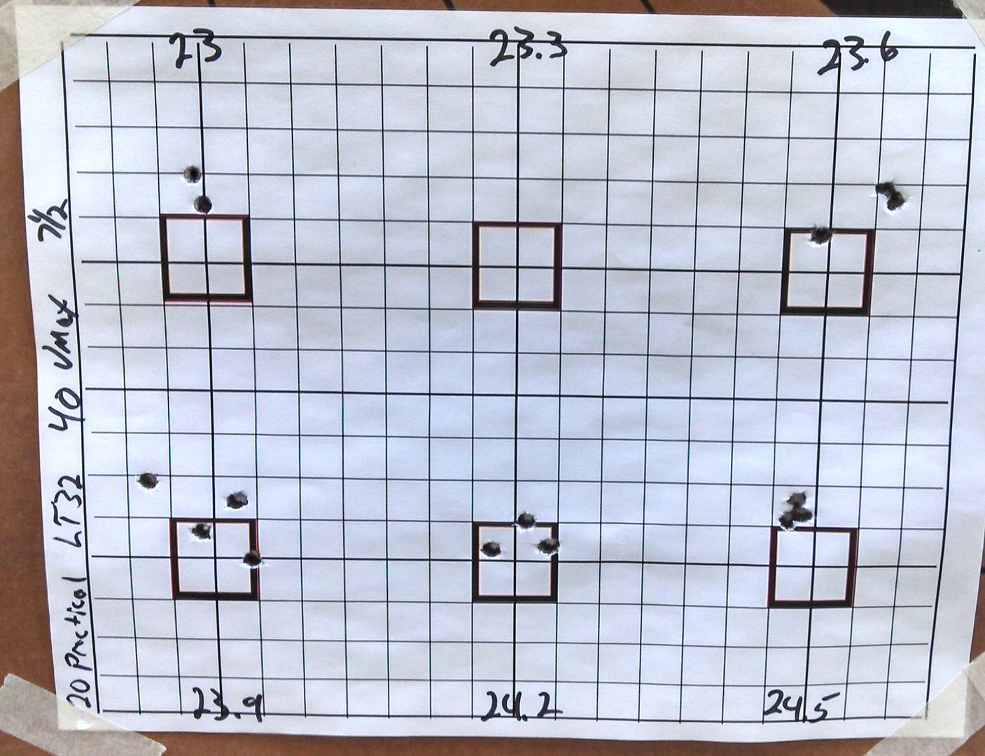

here is my 40 vmax data i am going with 24.5 load
Code:
23 LT-32  40 vmax
	  1)	3534
	  2)	3552
		 High:	3552
		  Low:	3534
		 E.S.:	18
		 Ave.:	3543
		 S.D.:	9
23.6 LT-32  40 vmax
	  1)	3643
	  2)	3663
	  3)	3674
		 High:	3674
		  Low:	3643
		 E.S.:	31
		 Ave.:	3660
		 S.D.:	12.8
23.9 LT-32  40 vmax
	  1)	3716
	  2)	3726
	  3)	3746
		 High:	3746
		  Low:	3716
		 E.S.:	30
		 Ave.:	3729.3
		 S.D.:	12.5
24.2 LT-32  40 vmax
	  1)	3792
	  2)	3752
	  3)	3759
		 High:	3792
		  Low:	3752
		 E.S.:	40
		 Ave.:	3767.7
		 S.D.:	17.4
24.5 LT-32  40 vmax
	  1)	3735
	  2)	3817
		 High:	3817
		  Low:	3735
		 E.S.:	82
		 Ave.:	3776
		 S.D.:	41

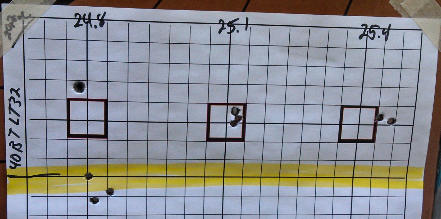

24.8 LT-32  40 vmax
	  1)	3853
	  2)	3853
	  3)	3852
		 High:	3853
		  Low:	3852
		 E.S.:	1
		 Ave.:	3852.7
		 S.D.:	0.5
25.1 LT-32  40 vmax
max load ligth ejector swipe	  1)	3884
	  2)	3903
	  3)	3911
		 High:	3911
		  Low:	3884
		 E.S.:	27
		 Ave.:	3899.3
		 S.D.:	11.3
25.4 LT-32  40 vmax
over max load	  1)	3944
ejector swips	  2)	3948
		 High:	3948
		  Low:	3944
		 E.S.:	4
		 Ave.:	3946
		 S.D.:	2

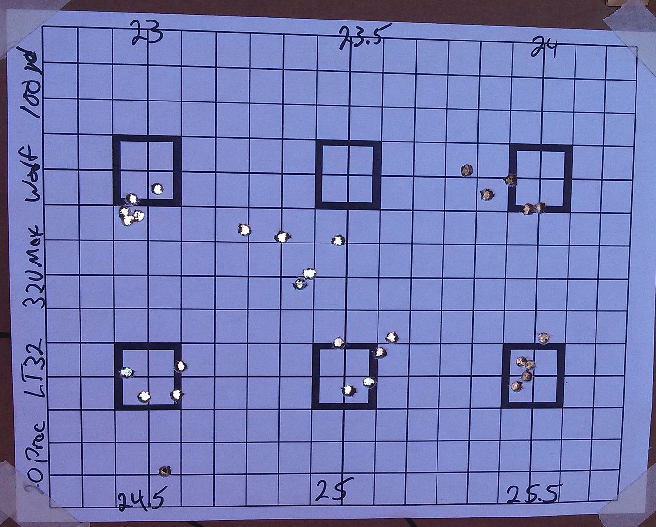

The first lt32 and 32vmax test
my gun is a 24" polygonal Black hole weaponry barrel 1-10 twist rifle gas on a dpms heavy duty upper.
Code:
23 LT-32 32 vmax
GOOD LOAD	  1)	3585
	  2)	3567
	  3)	3524
	  4)	3564
	  5)	3539
		 High:	3585
		  Low:	3524
		 E.S.:	61
		 Ave.:	3555.8
		 S.D.:	21.6
23.5 LT-32 32 vmax
	  1)	3521
	  2)	3622
	  3)	3633
	  4)	3654
	  5)	3614
		 High:	3654
		  Low:	3521
		 E.S.:	133
		 Ave.:	3608.8
		 S.D.:	45.9
24 LT-32 32 vmax
	  1)	3754
	  2)	3698
	  3)	3746
	  4)	3669
	  5)	3753
		 High:	3754
		  Low:	3669
		 E.S.:	85
		 Ave.:	3724
		 S.D.:	34.4
24.5 LT-32 32 vmax
	  1)	3777
	  2)	3851
	  3)	3810
	  4)	3857
	  5)	3733
		 High:	3857
		  Low:	3733
		 E.S.:	124
		 Ave.:	3805.6
		 S.D.:	46.5
25 LT-32 32 vmax
	  1)	3906
	  2)	3926
	  3)	3950
	  4)	3912
	  5)	3927
		 High:	3950
		  Low:	3906
		 E.S.:	44
		 Ave.:	3924.2
		 S.D.:	15.2
25.5 LT-32 32 vmax
GOOD LOAD	  1)	4019
	  2)	4040
	  3)	4028
	  4)	4026
	  5)	4042
		 High:	4042
		  Low:	4019
		 E.S.:	23
		 Ave.:	4031
		 S.D.:	8.7
Tsingleton said:
That 40gr vmax load at 24.8 is awesome
Can't ask for more than that
if you look closely that is a 308 stray hole the group for 24.8 is a little lower, the best nodes were 24.5 and 25.1 but it is over max or right at max.
but yes one large ragged hole would be nice ;D
