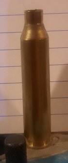

Second, while playing around with some scrap range brass, I noticed that after going through the .235 and .225 bushing, the junction between the neck and shoulder doesn't look quite right. It's like the new portion of the shoulder is at a slightly different angle. It almost looks like I didn't run the die down far enough. I can see where the case head has been sized so I'm pretty sure the press allowed me to run the brass all the way into the die body. This kind of makes sense because that portion of the brass is unsupported in the 223 die body. My concern is that this could cause an issue with brass being able to fully chamber. Seems like this could be an even bigger problem on an AR upper. At least with a bolt gun, it would be obvious that I couldn't close the bolt. I don't have my upper yet, so I don't have a good way to check and see if this is an actual issue. Has anyone seen this before? .
I haven't pulled the 204 button through anything yet, so maybe that will "fix" things. I'll try to take a few pics of some brass tonight (ran out of time this morning).

It sounds like you are starting to get the donuts at the neck/shoulder junction based on your comment. Try annealing the test brass as it will help.

When you size down the brass it will look like that. After you load and fire it will blow the shoulder out to your chamber. I have one in a bolt rifle and love it. Dont know what the reamer print will be on urs but with mine its a tight chamber by design. Hell on a fired brass i can not even seat a bullet with out a die. From what i read the original design was to be tight but not needing necks turned. On virgin brass my bolt has resistance due to false shoulder. After firing and resized its all good. Dont know how a AR will be. You will love this rounds. No recoil!!

As JB10 noted the nk-shoulder junction is normal after necking down. When you say .204 mandrel are you meaning 20 cal?

I was hoping that's what I was seeing, but wanted to double check before I started working on the 1,000 pcs I have set aside for 20 Practical.

For reference, this is what the neck and shoulder look like coming out of the .225 bushing. I don't think its a donut. Part of the folder just hasn't been formed yet. Fire forming would definitely fix it, but I was concerned that it could cause a problem with chambering the loaded round.
