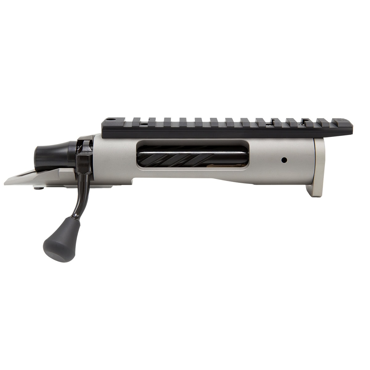

Found this new action: New take-off short Action...round back...center feed...223/204 bolt head.. jeweled bolt, .4.40 inch screw spacing...varmint Accutrigger adjustable down to 1.5pounds...flat black factory finish...jeweled bolt body...larger "varmint" bolt handle...original slotted nut and recoil lug. NEVER been fired except at factory
$285 plus $35 shipping and FFL here.
Center feed means it can use detachable mag? But would need to buy they bottom hardware to use a mag, not sure where those are or cost, and then which stock would work with it.
If you put that action in a chassis, then it will come with the bottom metal and accept AICS mags. I used an ORYX chassis and think it is a great buy for the $. While the 20P will feed just fine from the mag, I prefer single shot for squirrels.
That action is a great start. Having put together a few Savage rifles, I think you'll really enjoy the results of your build. A 20P is on my list of builds and I think I'm going to have it done on a Rem700 because I have one that I can use, but I wouldn't hesitate doing it on a Savage, as like you, I can do all the work myself. As long as you have a decent stock, I bet you'll find a good shooter with any of the aftermarket barrel makers.
