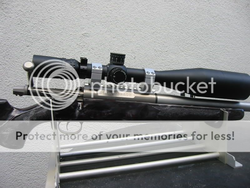

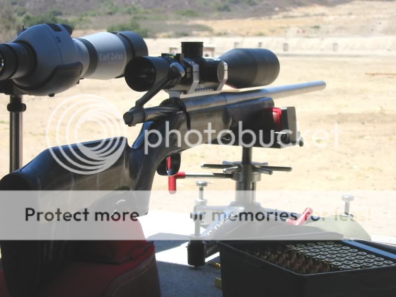

If your interested here is my .20 Badger Buster
These are the fireform groups.
SDH
Thanks SDH! Gorgeous rifle you have there! I'll have a reamer in hand next week but I'm not sure when this project will really get going. Got a baby girl due in a couple weeks.
