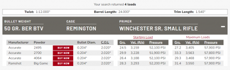

Looking for starting loads for the 20 br, 1-9"twist, w 55 gr bullets . Want to try rl 15, a2520, varget, etc. What powder do you like? More importantly want your starting load. I'll work up to the sweet spot myself, just need to know where to start. Thanks

These are what is shown on the Hodgdon Web site but not for the 55.
Many tables predate the 55 and show the then 50 gr which is obsolete now.
This will give you a good feel for how they run the powders shown.
Lately, it seems like Hodgdon is adding loads, but pushing those other brands (Accurate, Ramshot) that they acquired and showing few new loads with the Hodgdon, Win, or IMI powders.
I don't mind seeing those other brands, but wonder why they don't show the H, IMR, or W that much?
20 BR loads.
Now just for comparison, when I play with QL or GRT, I like to see what other published data there is for "close" to the 20 cal, even if it isn't the same diameter. So, they show 22 BR Rem loads but this time they show the Hodgdon powders. You don't get to see the Accurate or Ramshot powders on this cartridge, so it isn't easy to extrapolate to the 55 gr 20 cal, but it is still useful.
22 BR Rem loads (Not 20 cal)

Thanks for the reply, I had looked at hogdon, and noticed the same. I also found data from accurate for the 50 gr, from b4 the purchase by Hodgdon. I assumed they published the older data,hence the no Hodgdon powders. So with 22 br data I need to back off that start data, as the 20cal 55 is a bit longer then the 22 cal 55. Would 10% be enough? W the 50 grain .20 I’d think 2-3grains would be plenty? I’ll reread terrific 20s, im sure I can find more info there as well. Most of what I’ve read here is where they shoot well. I’m sure I can back off 10% from those and be good as well.
