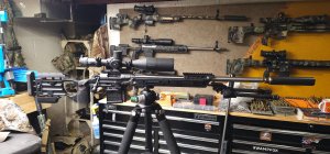

Projects are being built on a KRG whiskey chassis and an MPA matrix pro
Ill keep you posted

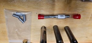

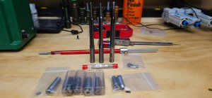

PTG finish and roughing reamers

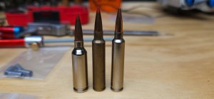

20 majestic next to a 22 Creed reamer

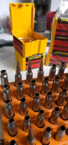

Once you start on a project like this, it's a good idea to get some die blanks from PTG
To ream for case work .

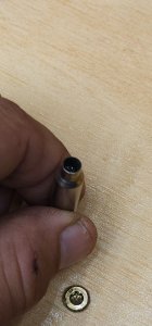

I also grabbed a set of 204 ruger
And reamed them out
I will be using my reamers
On my 22 arc and twenty 22 250 dies once my reamers get here.

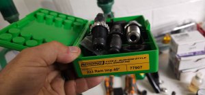

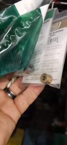

I grabbed up a bunch of redding bushings ahead of time
Even have extras laying around

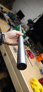

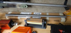

Hart Barrel blanks
204
1 in 7
26"

I really love the 20 majestic so far
I can get twenty nine grains
Of 2000 MR in the case and it only fills up to the shoulder.
I was getting close to twenty six hundred feet per second With twenty eight grains
With the 55 Bergers .
I can't wait to see what 2230 is going to provide.

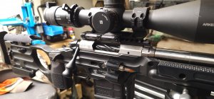

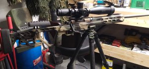

When I started this project, I grabbed up an aero solus action
As it was affordable and offered all three bolt heads that I needed for this project
Then Brad at urban riflemen
Told me about the Kauger company
He's a great guy and I listen to his advice
Let me tell you something this VPR action is saweet...
And they have bolt heads for sixty dollars
I can change this thing out
In any of my custom calibers in an hour
