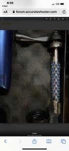

I will respectfully disagree with the claim that there is no savage trigger suitable for benchrest. I have owned a gun that had the trigger work done by Sharp Shooter Supply. I can’t say exactly what they did but whatever it was, they got it right. The trigger broke like ice consistently right under 4 ounces. I could go from any of my guns with bix or jewels right to this gun with zero problems in execution. The gun had a custom bolt that had been trued and nicely fluted. Still wondering if I should have sold it.
