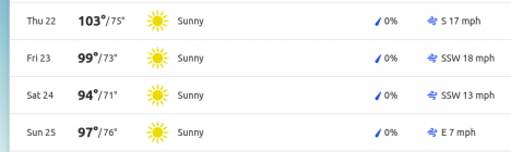

Weather 105 - Wind ~6-8

Don’t do LD when it’s 105.

Ugh it's gonna be that temp for a while here in Vegas. I need to get some rubber feet for the bipod. This is a concrete bench with a rear bag that needs a to of coaxing (weibad fortune cookie). I'm using CCI450s. Optic is a vortex hd gen II 4.5-27

Looks like next weekend is a op for you in the mornings, esp Sunday with lighter wind. Obviously that can change but if you're flexible... suggest trying a lighter load, esp in hot temps. Maybe for grins try 39.3, 39.6, 39.9 just to see if there's any change, at least in the nose bleed temps.

Damn might need a jacket lol
