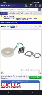

Are you guys taking about the distributor pick-up coil? Would that affect the fuel pump?

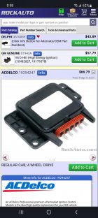

Here's a pic of yours.
The fuel pump will not activate without a signal from the "ignition control module", commonly called the dizzy igniter by us wrecking yard rats that have seen this problem dozens if not hundreds of times.
This problem will drive a person nuts. Just replace it, it's $30.
