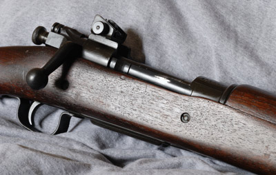

Im new to older firearms and I picked up a 1903 online with a 3 day non-firing inspection period. Id like to shoot it occasionally and I would notice if it shot poorly. Ive attached 4 pictures for the barrel at throat, near throat, middle and end of barrel. I was hoping someone with more experience than me with these things could give me an opinion on if it is shot out.
I noticed the claw extractor on the bolt also pivots when I turn my hand. On a previous one I handled it had resistance and required your finger to move. Those are my only 2 concerns. Thanks in advance for whoever might know these things. Thanks.

I have had 2 1903A3's with one being a Remington and the other a SC (still have the Remington) and they were the same but very different as far a barrels were concerned.
My still on the scene one has the 2 groove and while it still shoots very well, it's barrel would need to be replaced if I really wanted to see some accuracy improvement. I actually do have a 4 groove barrel around somewhere with a close enough date code, but it would not be original then (who really knows with these rifles unless it has a good provenance).
IMHO, in the pictures you posted that barrel may shoot decent, but there is a good amount of fire checking. You may be able to smooth it some but that has it's own problems (barrel life). As far as the extractor is concerned, there are still lots of replacements out there or you can tweak the one on the rifle. In other words, the extractor should not be a real issue.
You said 1903, so I will assume it is not a A3 (and by what appears to be a 4 groove barrel it should be). If it is in very good condition, all matching parts, good to you price, and you need an 03 (yes on the last one) I would consider it. But that barrel is not a long term part. Criterion replaces them with one of theirs for a not to bad priced barrel, but then it is not an original 1903 if that matters to you.

i would make dummy rounds and check feeding and extracton.
The barrel looks ok for a high round count rifle. Expect 3" groups @100 yds, using the original sights. Close inspection of the muzzle crown is needed. It will shoot very high. Aim at belt buckel on enemy for bullet to strike chest area. Good out to 300 yards? If i remember correctly?

One more point. If you do decide to keep that rifle, clean the barrel with a gentle abrasive like Flitz barrel cleaner. You may be pleasantly surprised. There's fire cracking of steel and there's fire cracking of hardened carbon deposits. You probably have both. The bore end looks OK. Just some copper that will scrub out.
No one mentioned it, but there are new U.S. military barrels that still show up for sale sometimes. Thousands of replacement barrels were made during WWII and they were surplused out cheap for many years. A lot of people stocked up and some are still showing up on the secondary market, All they need is final headspacing. If you want original, I would look for one of these if you keep the rifle. Yours I think is beyond accurate in the current condition. It might shoot fair with a clean/near clean barrel, but wouldn't take long to foul badly, causing it to shoot poorly unless cleaned frequently. On the extractor, sounds like you need a better one. With almost no tension, I doubt if it would hold a cartridge properly for any kind of sustained fire. As a previous poster stated, not a big deal. New gov't. surplus extractors are for sale almost any time on Ebay. Nice thing about the 03's is the large quantity of surplus parts still available, and most of it reasonably priced. Shows you how much we overproduced these parts. Nothing wrong with the accuracy of military Springfield barrels. Many of these military surplus rifles were used as is by high power rifle competitors with considerable success after WWII. Many were rebarreled with custom and made even better. My experience with military bolt rifles is that the two most accurate rifles (when in good condition) on average were the Swedish 6.5x55 and the .30-06 Springfield. Both were used by competitive riflemen to good effect by shooters in their respective countries and usually dominated these matches.
I finally got out to the range with it. It consistently grouped 2" @ 100 yards shooting off a pack with cheap federal ammo as I dont load for 30-06 yet.
Im quite happy with the purchase. If I want to shoot sub 0.25" groups I have my f class rig, I was just expecting worse (4+") or some fliers given the throat erosion. Thanks for the good advice
