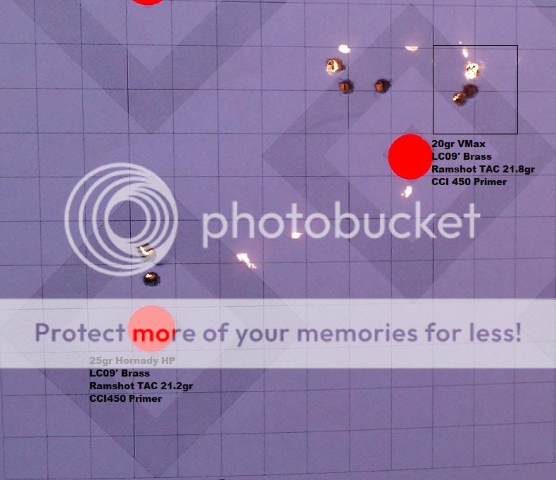

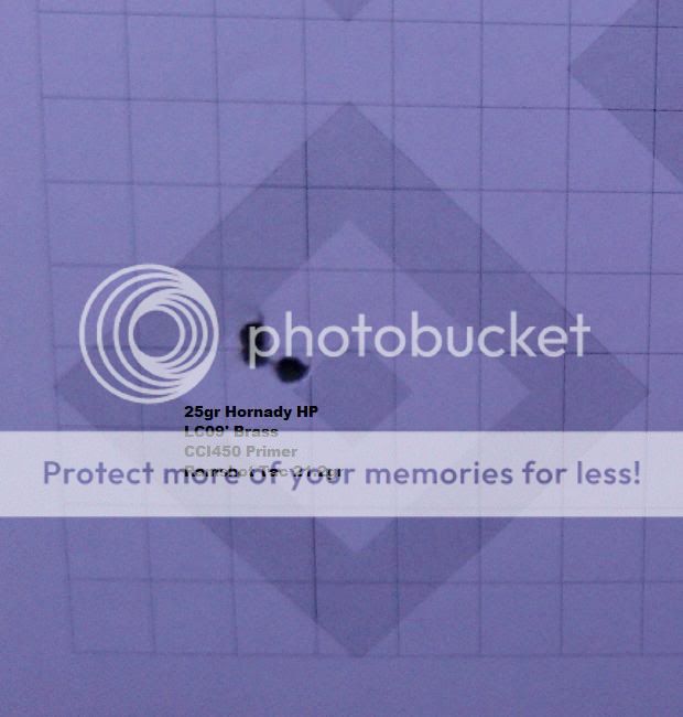

I fitted the stock and did the paint job, courtesy via onion bag and Krylon. It's pillar bedded and Devcon's like a glove. It's main diet is going to be something!?!?!?! I have 14gr,17gr,20gr,22gr,25gr, and 27gr bullets, lots of each so I have no idea yet. I figure I'll start low and go up in weights. Be neat to see some 14gr solids at 4800fps +. Anyway, I hope it shoots. Only one way to find out . Brass is coming from weighted LC 09' cases and won't need to much fireforming as they come out with very nice 30* shoulders and about .006" crush fit. Necks get turned to .198" loaded rounds. I did have to nip the ejector as it was beating the crap out of the necks, now they just fall right into the feed tray ( where I want them ). Anyway as I get it up and running I'll post pics. Adam
