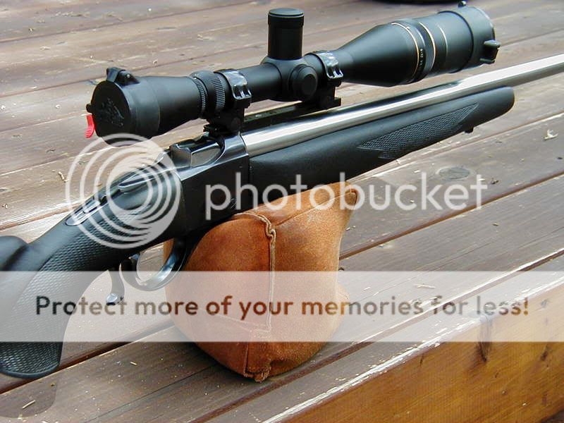

Hugh: I built my 17AH on a Ruger No.3 action with a 22" Pac-Nor SS Super Match barrel of sporter dimensions. I also do alot of high-volume ground squirrel shooting, usually with calibers from 17AH, 22KH, 17M4, 20VT, 204 Ruger, and of course a battery of .22 CF's.
That said, I can run as many as 200 rounds through my 17AH without cleaning (shooting WS2), and even when a hot string of shots is fired at squirrels, the barrel heat is minimal; you can easily hold and keep your hand against the barrel. I'm shooting the 20gr V-Max at 3,810 fps, and the effective range of this rig is right around 350+ yards, maybe a bit better in calm conditions. It will completely puree a squirrel out past 250 yards, usually with a decent "launch factor" thrown in for fun. ;)
