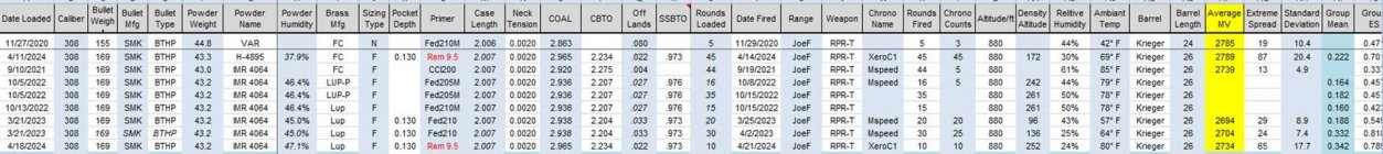

I tried IMR-4064 a couple of times with the 169 SMK's, but found my best results with AR-Comp. Here's my data for using IMR-4064 behind the 169's:
Note: even if I use the same COAL as yours, the velocity isn't a great deal more. :rolleyes:

Leaving that powder in you V4 in that low humidity pretty much explains a lot of your additional velocity. But, I'm really surprised that you're not getting obvious pressure signs. I do think you're pressure is way more than you think??? You might try a loading a couple cartridges using the powder from your 8 lb jug to see the difference???
That QuickLoad calculation is simply base on my velocity results, where I adjusted the burn rate up from what was QL's default rate to get the numbers to be consistent with my various results for the IMR-4064.
