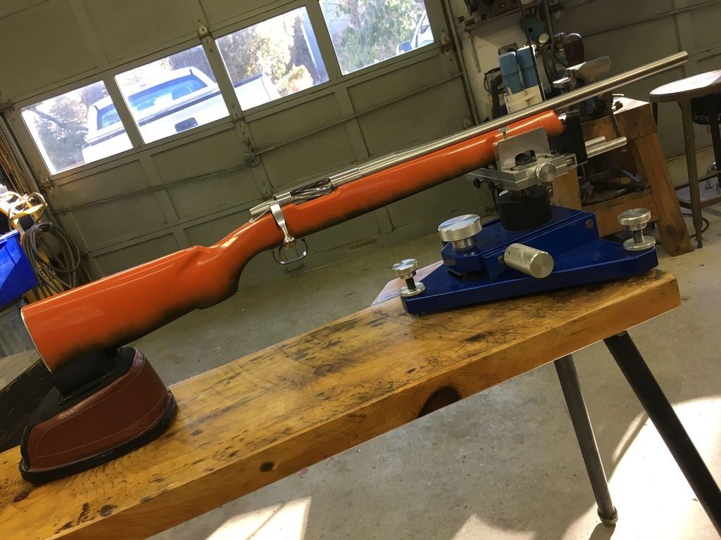

I spoke with the gunsmith a few day ago, all the work is done on the barrel job and it should be shipped this week. I expect to post some pictures next week. Below is a .14/221 next to a 20 Vartarg.
Now I can have some fun.

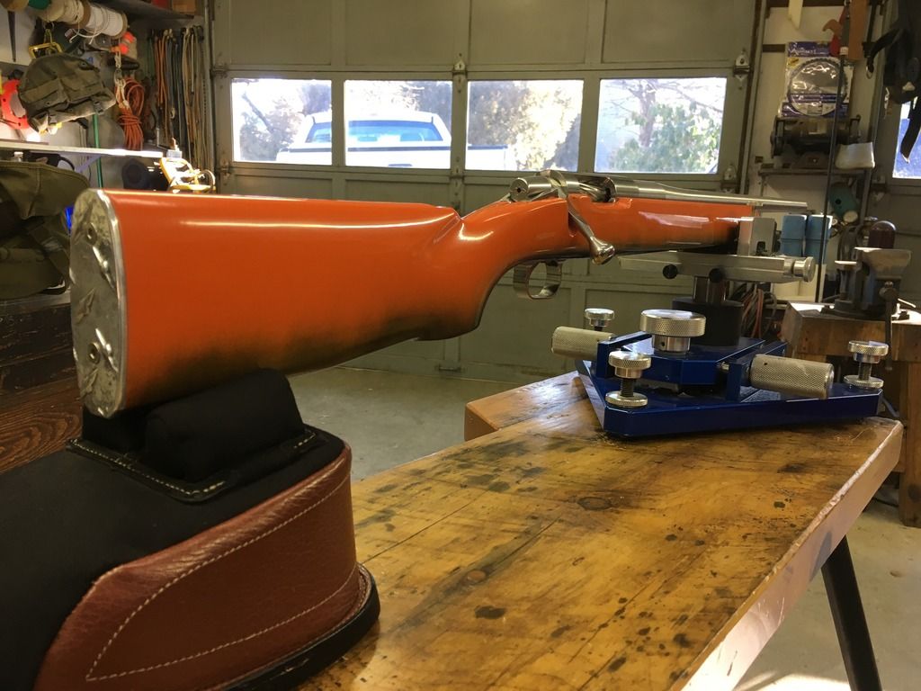

John, glad that is a small caliber. That but plate looks like it would hurt a guy. I like the fluting on the bolt also. Rifle looks like it will be a shooter.
