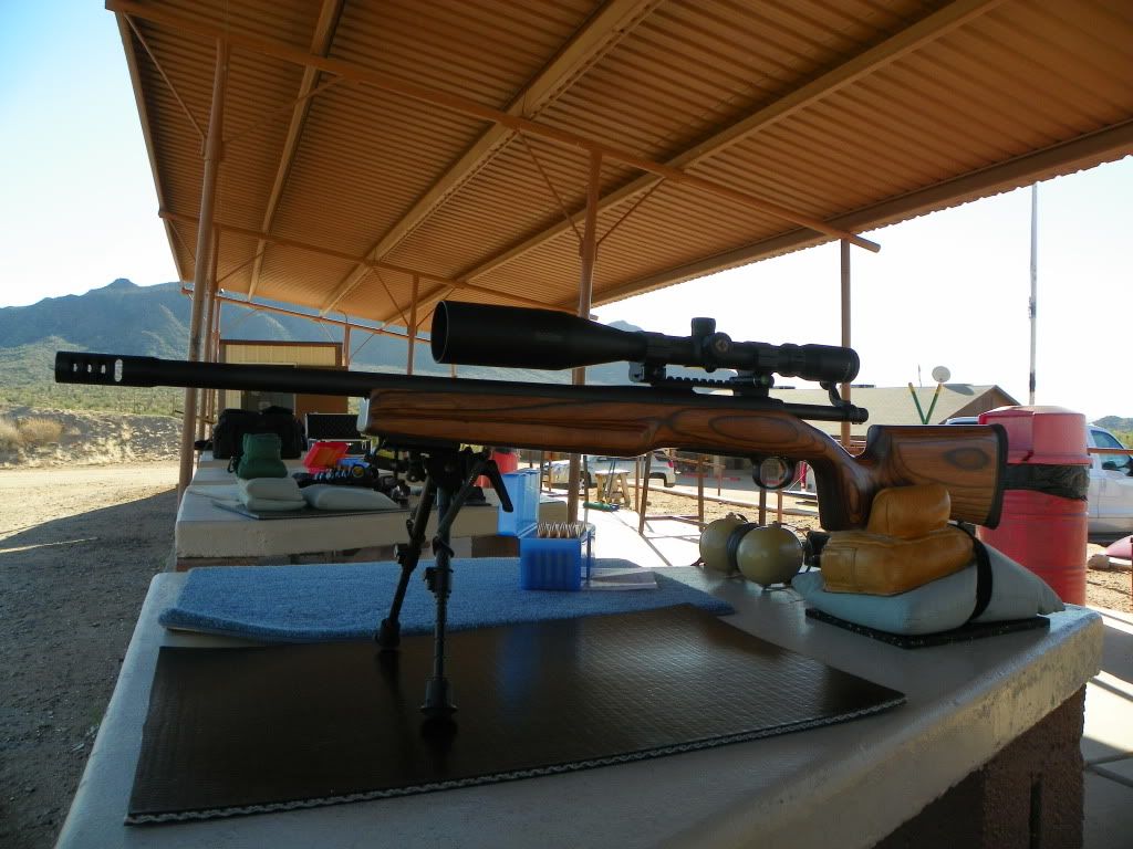

Here are a couple pics. Rem. 700 SPS Tactical with a Bobby Hart LRT stock that I got from Stockys and devcon bedded it. That is an EGW 20MOA base with a 6x-24x 50 Burris Black Diamond. It has a Shilen 2oz trigger.
The brake on it makes it recoil like a 223. I machined the brake and installed it myself but it is a copy of a very effective and popular brake. ( Muscle brake by Jim See @ Centershotrifles).
Tarey
Tarey, thats one beautiful rifle!! I like it! No luck monday on my end hunting, but my 12 year old son nailed a large doe which is his 2nd deer already.
