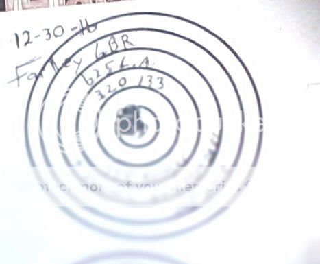

had Tim punch out my 13.5 twist 6PPC to a zero freebore .268 neck 6BR,,I started with some 62.5 gr bullets I got from Larry Averitt and VVN133 I had left from the 6PPC that is pretty slow for 133,,I started at 30 grs loading one round ever .3 grs looking for pressure and at 32.5 the primers were getting kinda flat so I loaded 5 at 32.0 and put them on paper,,
I will take that for sure but I am gonna try H335 and Barts 68s and some other powders when the weather gets better,,
I sure hope to get away from makin PPC brass,,
anyway first group with fresh chamber on Krieger bbl that had about 500 rounds of PPC on it
I plan to try all those and H335 and A2230,,this new 133 is pretty slow and I just thought I would try it with the 62.5 gr bullets ,,I have a little LT32 and 8208 on hand but need to run by the store and pick some stuff up,,
I found Varget worked better than H322 with the 68 grain Berger and Bart's Ultra. Both jammed 0.010" using BR4's.
