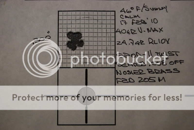

I built a 204 on a blueprinted M700 action with a PN 11 twist Super Match 3-groove 24" barrel to match the Remmy contour. It shoots the 39SBK and both the Nosler 40gr BT and the 40gr V-Max into one hole about every time.
The 40gr V-Max is usually the bullet most 12 twist 204's will either shoot or flatly refuse to shoot worth a hoot. My other three 204's will not shoot it, but the 11 twist doesn't mind the 40gr V-Max one bit:
It seems a 12 twist 204 is a crap shoot....you won't know until you try the 40's.
