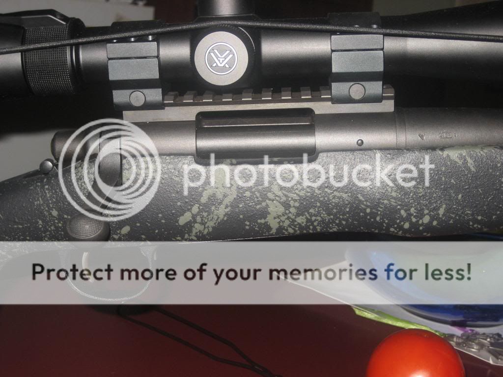

The gun in a BC stock, skim bedded and a homemade paint scheme to help blend. BTW I was getting 2960-2975fps out of this load with Win brass, Win Mag primer, will be shooting the fireformed this weekend
