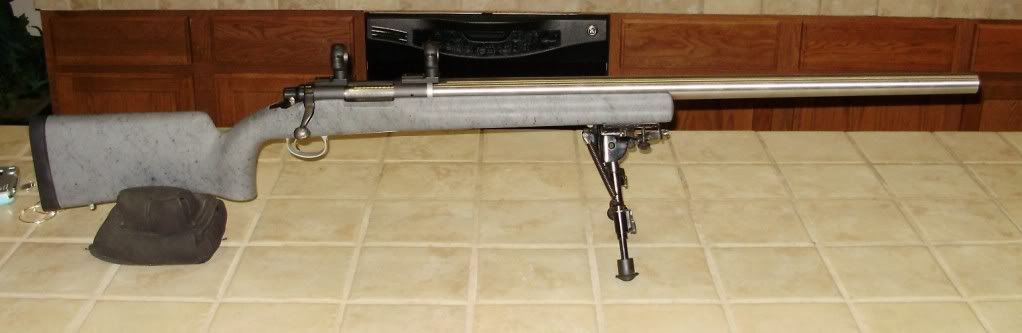

wow man! that's awesome. post some pics of your rig if you can. are you using the target accu-trigger?
Every rifle is different. Give em what it likes. If accuracy is good when jumping, keep doin it. I only shoot the 105 A Max in a factory Cooper 6mmBR eight twist. That gun likes them jammed .010". You need to experiment.
alright. ive got to show off some pics of it.

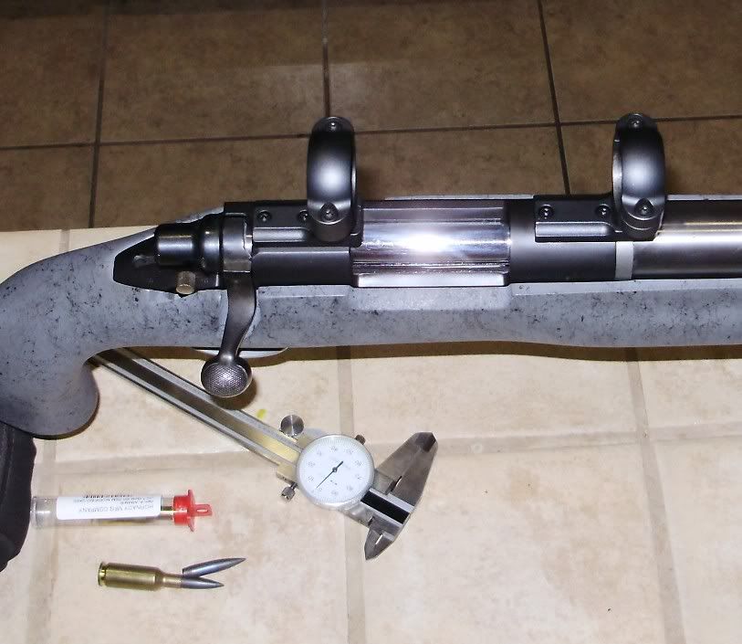

The bolt was jeweled, but was getting pretty ugly, so i decided to go a head and polish it out. it looks a lot better...

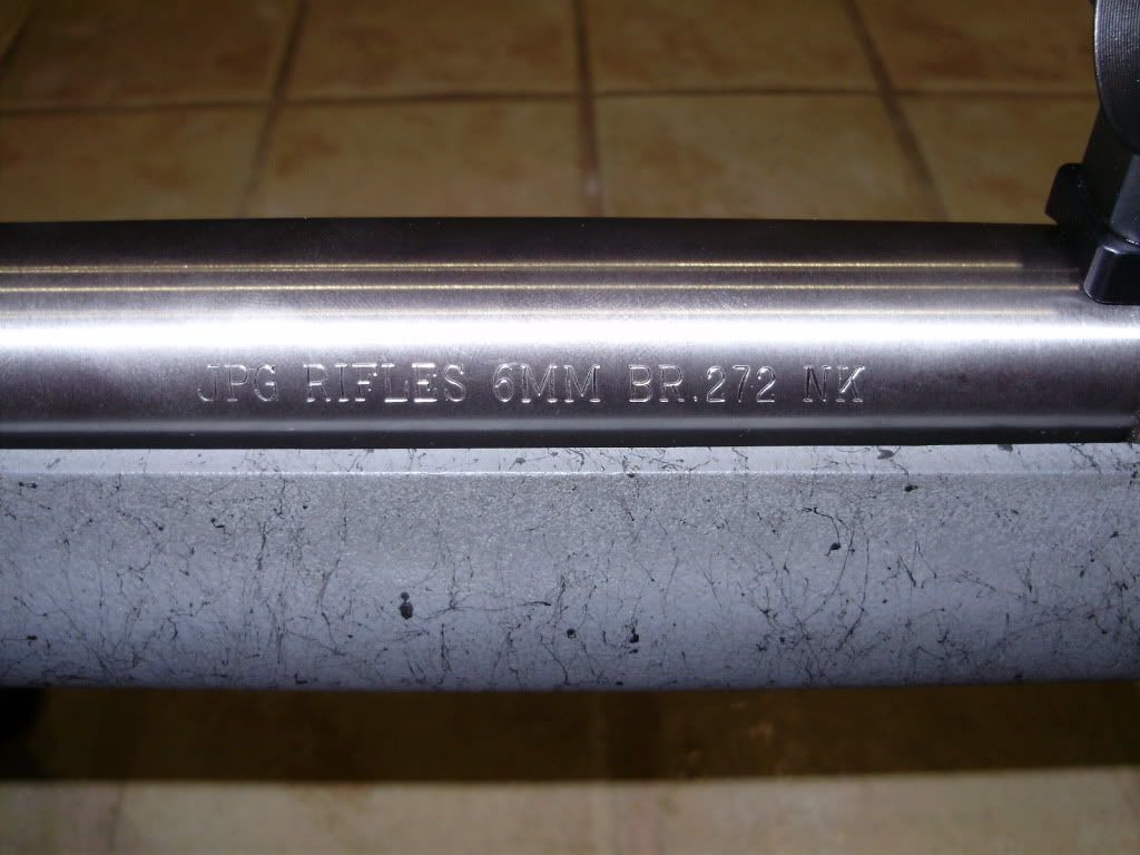

Johnson's Precision Gunsmithing is a site sponsor and you can check out his website at jpgrifles.com
once i get some brass, we'll see how she shoots. until then, i'm going to bed the action (Leroy would have done the bedding job, but i enjoy doing what i can within my abilities) and put the Jewel trigger back in it. oh, and ive gotta get the Leupold 8.5-25 LR target scope back on it.....
