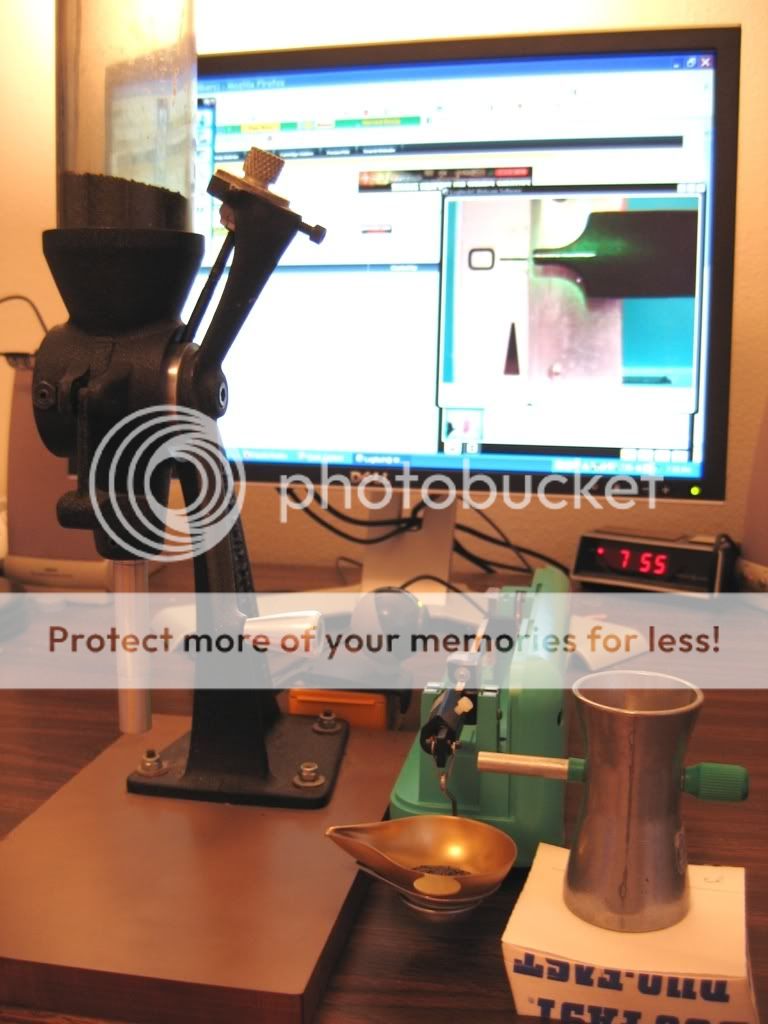

Intrigued by a recent Daily Bulletin piece combined with a similar video on You Tube, I set up my SAECO powder measure to throw just under 30 grains of 133 with the scale turned ninety degrees so that the pan was near me, to the right of the measure and to the left of the trickler. With the web cam giving me a large picture of the pointer and scale on my computer screen, I was able to start with the pan on the scale, throw and trickle a charge, to a quarter of a tenth in 18 seconds, repeatedly. If someone can come up with an angled drop tub that will allow throwing directly into the empty pan, on the scale, without powder bouncing out I can cut a couple of seconds off of that. You have to hustle at the beginning and slow down a lot at the end, but it can be done...consistently. The other part of this was learning how to work over my scale. I got lucky and it made a huge difference. (I timed by counting with the beats of a free metronome program set for one beat per second.)

Here is a still picture. The screen is showing .1 gr. high.
