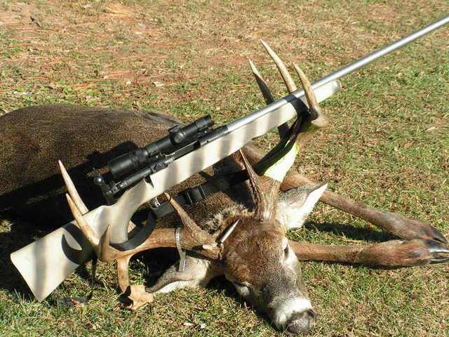

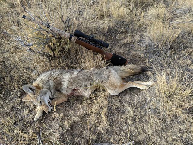

I'm not a low end vortex fan but use a lot of 1-4 to 2-12 scopes for hunting. If I can see the animal with my bare eyes I can kill it with a scope with a 1-4x20 scope. Having a bold reticle that you can see in low light is about the most important thing.
1-3x20mm Weaver Northern WI
Bushnell Elite 4500 1-4x24
Leupold compact 2-7x32
I could keep going but you get the gist of my like of low powered optics. Again bold reticles are the key, Heavy duplexs, German #1 & 4 work well. I tried illuminated dots, they work but some can be too bright even on their lowest settings and seem to obscure the image.
