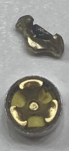

But 1.2 grains of what turns out to be elusive, migrating, squashed up anvil in your lug recess after sighter 2, in a 45 second shot pair fire match means game over.
It turns out that 1.2 grains is the magic amount that at once, a bolt won’t close on, a contorted pinky finger can push away without ever perceiving, and a grease film can suspend against gravity such that it can hide anywhere. I think the record for resolving such a problem is about two meals later.
