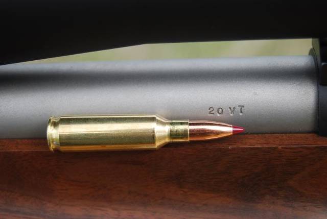

I have a 20 VT & 20 Practical. The VT is my favorite and is what I start with in the PD fields. Both handguns have 15" barrels and brakes. The recoil is mild on both, but I put brakes on them to make it as easy as possible to see my hits and misses since I hunt alone.
I formed up a lot of VT brass when I first started and haven't had to make up any additional brass so far. I really like the VT for it's very mild recoil and flat shooting. On a low power, I can easily see my hits and misses. If I had to do it over again, I would just make a .20 Fireball. It would still be very flat shooting and much easier to form brass. A 20 Fireball would take a lot of steps out of forming up VT brass.
My .20 Practical is also very accurate and flat shooting. There is definitely a little more recoil on the Practical. Even on low power, it is sometimes difficult to see a hit or miss.
Making a set of brass for the VT is a little project and once you have done it you will run the life of the barrel. You will have to hunt down good brass, but then it is a done deal.
The 20P is the easy button. You make a set with good virgin brass and you are done for the life of the barrel. My guess is you should get this one going first while you work on the VT.
Life is too short to worry about the difference. Get going with one and then do the other one too. When you are too old and sick to shoot, you will look back and be glad you did it for the experience. Carpe Diem!
20 Vartarg hands down. I have both and I always reach for the VT first. I have several 400 yard plus hits on squirrels with it. Once you have one, well, you will want another. I'm in the middle of making 1,000 more VT cases right now and it's a LOT of work! A perfect winter project. The easy way would be to buy some brass from here on the forum. Nothing like having a rifle that just makes you giggle every time you shoot it.

I've got both the 20P and the 20VT, and hands down, the Vartarg is my favorite. The 20 Practical is very easy to make and is very accurate. But, the Vartarg uses very little powder, has low recoil and is easy to track hits, is very accurate. I make my own VT brass, from LC as L.Sherm does, and they last. Myself and other sell 20VT brass here, so if you don't want to make it, then you can get good brass here, cry once, and "giggle" after that! :D

I know just what you mean on forming VT brass. After forming so many 223 brass to VT brass, I chambered check every piece of VT brass. Many of them would not chamber properly, bolt wouldn't close, hard bolt closure, etc. Those would be discarded. I only kept the VT brass that would function property.
When all my VT brass is gone, I may try a .20 Fireball. Just neck the .221 down to .20. Similar to the .20 Practical forming.
I've only made probably 2,000 20VT and SCC cases with out zero problems and working on another 1,300
You screwed up something, if there run through a 20VT die set up properly then why wouldn't they chamber? Did you turn the necks? Unturned 20VT made from 223 will be .232 loaded dia give or take.
I've made about 2,000 VT and SCC cases with zero issues and currently working on another 1300 not including 600 17 Javalina and 1,000 17 badger cases ive made.
