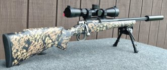

Are you looking for something with that much muzzle dia. because you intend to screw a can on it? If that is your intention a Hart #5 or Bartlein 3 or 3B would be my choice but if you aren't intending to run this with a suppressor AND you're looking for something as a lighter varmint rifle I'd go with a Hart #4 or Bartlein 2B contour. Any of the above will result in larger muzzle diameter the shorter they get. On the above mentioned Bartlein's they're .012 of taper per inch. I run a can on everything so I've been using a lot of Bartlein's 3B contours but my 20-222 has a Hart #4 finished at 26 and it's more what I'd consider a lighter-ish varmint rifle. I don't exactly recall what it weighs but it's one of the lightest rifles I own. I could weigh it if you're curious what a setup like it weighs.
My next one is gonna be a #4 @ 20".

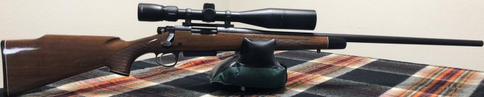

20 cal hole is small. I have a Wilson # 4 and Bartlein # 3 in Remington stocks if you want a pic of what they look like I cld take pics tomorrow
