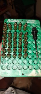

So let's talk about case forming again

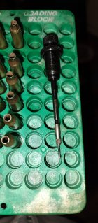

tried what a friend on another said about taking the decapping pin out and my crush case amount went way more down which when you think about it it makes sense. More downwards force coming down on that neck as you try and shove it up and over that expander ball and all that, and I de cap everything Separate on a universal decapper anyhow. Interesting little deal reading has with knurled end here. Slips right in the case since it's smaller then the expander ball but still can see something possibly getting hung up
And just our if curiosity wants to see what the difference would be in one that that formed with the pin vs if I used the pin after forming annnnd nothing noticable...at least to me I'm sure you guys have much better methods and tools to measure such things lol

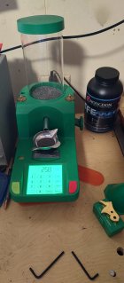

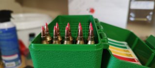

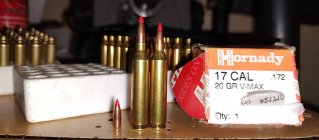

So loaded up some of the 20gr vmax's per KAK's load data. Did go and check my shoulder bumps and all that and everything chambers super easy via me pushing ithe bcg in with my thumb.
Using CFE .223.... because it was the cheapest thing they had in the self that KAK had on there load data lol

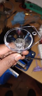

Will say.....I remeber why I don't like this bally flaky type powder very much , good ole statics gonna get one of them face metal set one day. Though it's pretty easy to fix this just tap the bottom of the case on the table and it all goes in. Really need to invest in some of those nice metal funnels with the inserts. Never saw the funnel as a vital pice of equipment till lately lol
Ten rounds for initial " will this blow up in my face " and getting on target. Think these are supposed to be at 3800 something fps. And that's a starting load which to date is the fast thing I've ever loaded lol
Good little bit of mag space as well to play with but apparently.17cals like to be jumped apparently so we will see. I usually do every thing custom but I wanna test KAK's claims of this being simple and easy to get to work

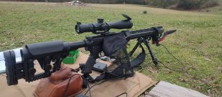

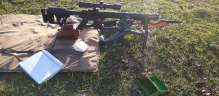

So the set up ( for the first then shots, more and more I'm just not enjoying shooting off of a front rest , idk just not my thing)
Prone , Caldwell rock BR front rest , magneto speed bayonet Chronograph. My heavy leather rear bag, 63 degrees out no wind

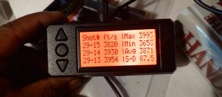

So first ten rounds didn't want to read or where reading some crazy numbers but I bore sighted and sent the first five in @50yd to make sure I was on paper. Also worked as a function test
And some screen shots I took in order of the first shot breaking
Screenshot_20240114-190154.pngScreenshot_20240114-190221.pngScreenshot_20240114-190256.pngScreenshot_20240114-190316.pngScreenshot_20240114-190339.png

Okay, looking forward to seeing targets! BTW, the static on your funnel, which causes your powder to stick, you can wipe the funnel inside with a used dryer sheet, like Bounce. That will remove the static charge on the funnel. I keep some in a ziplock by my reloading table.
So looking like a out 2 o'clock ejection with means a few things according to this. But after talking to some are fanatics I was told yes I'm over gassed as all get out but honestly it's no big deal for my uses. Mabye a adjustable gas block or some buffer weight but for the most part I was told just to run it.
Also gotta say, this thing has like no recoil and I think I might start going the thread protector route.
Anyhow everything functioned perfect. 100yd group was ..meh but very rarely I've had a beginning load start great. Also might have just been me trying to get on a new build

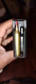

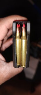

Now the next loads shot better but started getting some problems , honestly the only problem I had with the 26gr load was the rounds weren't picking up from the mag. Walked inside switched mags problem solved. Was still having issues with the economy picking up these little bullets so only two sensible velocities

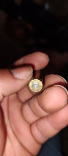

Now according to KAK's load data 26.3 gr is supposed to be the optimal load ( also the top end load for the powder bullet combo) this was where j was getting problems though. The main on being two of these.

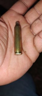

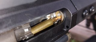

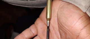

Now at first I wasn't sure what to think . Did the whole SPORTS thing , drop the mag ,yadda yadda , and the bcg just would not grab the case, weird, well went inside grabbed a cleaning rod and a little tap tap and it came right out. But ....
Believe it or not but I think this is the first time I've had this happen to me in reloading , so very interesting experience . But easy fix . That happened twice but only on this load so ..neat

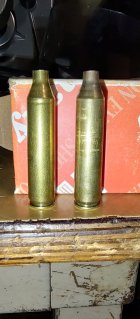

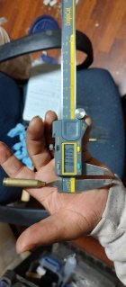

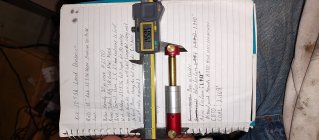

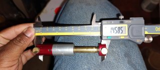

Back at the bench not what I have fire formed brass I can finally look at some stuff I need. This is what I usually do. Just size the brass so it fits or per the die instructions shoot it then take my measurements off the fire form brass and do my bump.s off of that
Left if freshly formed the right is fire formed

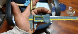

And some head space measurement. Again I Formed this brass per the companies instructions
Vs fire formed
So yeaaahhh I've been bumping these back a whole 0.008 vs... you know like the 0.003 I really need

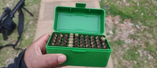

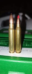

So did some seating depth testing. Seated them a bit longer and went back to 26.0 GR of CFE .223 . 26.3 just seems like too much due to it being the only load I had brass issues with.Also for craps and giggles threw on a $100 ffp chicom scope on I bought off of Amazon and gotta say, other then the really short eye relief, ITS NOT BAD ! Better then most of the Walmart rack exclusives lol. Actually tracks pretty decent too.
Next to one of my 5.56 loads
The set up
I kept the same powder chard though all of these .....really not liking that S-D but hay
And the target the group on the right was some brass that was kinda messed up and I was trying to see if I could fireform it out.
Ballistic-X-Export-2024-01-15 14_49_58.031612.jpgBallistic-X-Export-2024-01-15 14_51_35.022549.jpg
And as usual I end up seeing a round out the group ! Was the last shot and I felt it go wide...telling yourself " don't screw it up don't screw it up" seems not to help much lol

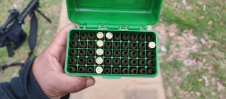

But yeah heres 50 rd of brass , the ones with the primers up are the ones with messed up whatever
Nice ! Thanks for the tip
Take that decap rod with expander ball, chuck up in a drill motor and cut the dang knurls off. Go to harbor fright and get some of their fine sand paper and polish that expander ball till it shines like a new dime.
FYI a q tip with a small amount of lube in the neck will make things easier also.
I would use the Redding small 17 and 20 cal decapper on all your fired brass. Size/form brass without an expander/assembly. If your Redding die is a bushing type, I would use 2 probably 3 steps(bushing sizes) to get the necks to 0.005 under a loaded(finished) rounds neck diameter. Than mandrel the necks, 0.169-0.170 mandrel.
With your groups, I would chamber, unchamber a round and measure coal. You need to make sure your sizing and bullet seating diameter is holding the bullet in place with NO movement. If the coal is changing during chambering your groups and velocities will suffer. Also over gassed is hard on brass and groups.
I store my funnels stacked with a dryer sheet between them, and my powder measure is empty with a dryer sheet in the hopper between use. W760 can yield very good groups with the 17's.
Annealing the case necks prior to forming and deburing/chamfering the necks will be a big help. Remove all lube after sizing is complete.

Your seating depth change helped, you can tune out that vertical with the powder charge weight. Once you have the neck tension consistent and brass ejects correctly. I use 556 brass formed to 17 rem for my AR( lose brass hunting in the snow, don't want to lose my factory 17R brass). Get 0.002-0.003 neck tension, add .5-1.0 gr powder.
