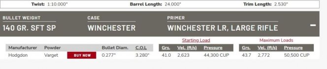

The Hodgdon website lists Varget at a starting load of 41 grains for 140gr Swift soft points. Sierra lists starting load at 45.7 for Varget. Hornady does not even list Varget as an option.
I would like to start at 41 grains of Varget for both bullets and work up in small increments to test velocity, accuracy and recoil. With Hodgdon's listing, is that an accurate assessment to go that route with different bullets of the same weight that are both soft points?

Well, called up Hodgdon. Let me say first, they are awesome!
1) The article in Handloader Magazine that stated IMR-4895 can also be used at the 60% load of H-4895 is false. They need to do a redaction.
2) Found what I needed in A-5744 and that powder is in stock.
3) The 41 grain Varget load I was asking about can be used with any 130 grain SP.
4) All load data provided is for copper jacketed lead bullets.
Thanks for all the inputs!
