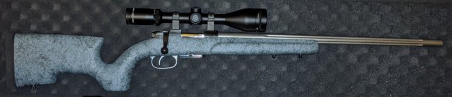

Finally. CZ 527 - 223 donated the action. Lilja made the 1-11", 3-groove barrel. Stock is B&C. The scope I took off the original went on. No time to get/fit anything else.
My GS, Mike Young, did the awesome work he does for me in record time. He also took the hump off the bolt.
She arrived the afternoon before I left for WY. So I quickly made 50 rounds with a mild load, 32 Vmax with 26 gn of TAC behind it.
Will report back when back home.

Looks like a nice rig! I have an AR upper 20P, I've thought eventually I'd love to do what you just did, a nicely configured bolt rifle. I'll be looking forward to what you figure out with the barrel and fouling.
Great looking rifle and great round. I built on a few years ago and really enjoyed it. 39gr BlitzKings were it's favorite pill.
