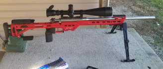

So I got my Harrell tuner installed on my Vudoo 22 S ( shown w/o tuner, but it looks the same as every other one) Trigger Tech trigger set at 4 oz. Love it. (Hated the Jewell, at 1.5 oz)

Here's the initial tuning:
Observations:
1. The first 6 shots, adjuating from "zero" to 25 to 50 formed a nice tight group, then opened up as I adjusted from 50 to 75 to 100.
2. The 100 to 200 group was all over the place (focusing primarily on the vertical stringing, not the windage)
3. The first 6 shots in the 200 - 300 group all grouped nicely . (at 200, 225 , and 250)
4. I then first 5 shots groups at 0, 25, 50, and then against at ). Mixed results (pictured above, second target line)
So I fired 5 shot groups at 0, 50, 200 and 225.
Right now, I'd say my sweet spot is 200 , but I need to re-test / repeat / falsify that setting.
Interestingly, John Langley (on another build) said to start at 150 and work up. Seems about right.
