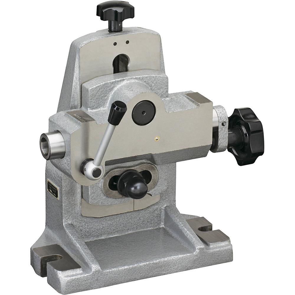

I've never fluted a barrel, but if I would set up a BP I would chuck it up in a index head or rotary table and support other end with a tailstock or center. Then slide an angle plate up against the middle to keep from deflecting. Then get a side cutter with desired radius in it and let her rip in low gear and a slow feed. Lots of tap magic steel or compare able cutting oil.

Make them level with a dividing head to index. Also you need the horizontal mill attachment with flood coolant and a power feed thats slow slow. Flutes wont look right with a ball mill IMO

If you were willing to use a side cutting tool you can use a couple big hex nuts with set screws Just bore the nuts so they fit on each end and secure with a set screw Basic machining from there You could do it with a ball mill this way but it would be more involved and probably easier to use a dividing head and tailstock Also a mag chuck like on a surface grinder clamped to the table and up against the side opposite the cutter works pretty good to help the chatter

I don't have pics anymore of my set-up, at least not in this 'puter. But, it consists of my #2 dividing head and its' center and 2 angle plates , for back-up. Now days, I use the 10 x 54" vertical mill with CNC at the shop, where I work, instead of the 'manual' in my gunsmith shop. The CNC is 'conversational', and the program is easily altered to 'fit' the barrel taper. We have a 4th axis, but I have yet to mount it for a fluting job, as I only cut flutes for myself. I still just use a dividing head, its' center and a couple of angle plates to keep deflection down. The dividing head I use is 'keyed' to the table slots. Always been close enough I can see no deviation in flute depth by eye. The only difference between the manual and the CNC is the surface to be cut needs to run parallel on the manual, which can take some time to set-up. And, the manual is belt drive so I can not set cutter RPM just where I want it. The CNC is variable speed, just enter the number.
