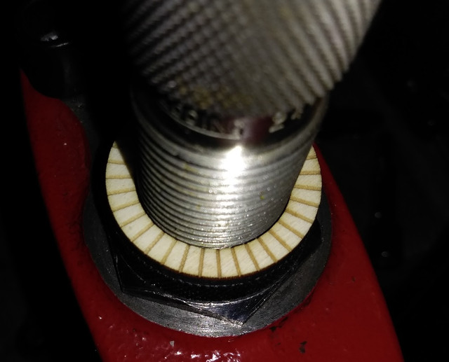

Regarding those labels for die lock rings.... many years ago, I asked Redding and RCBS to stamp one side of their die lock rings with 36 even spaced lines so die vertical position in the press could be precisely changed to ~.002" increments. Both thought it was a good idea. Especially with the case headspace measuring tools on the market. Neither has done it as far as I know.

I have made some rings for my dies in the past with a laser cutter and some ~3mm wood. They have a 22.4mm inside diameter and 31.7mm outside diameter. 10° markings.
If anyone interested...probably not, $2 for the first one, $1 for each additional?

This label on the lock ring has marks showing how far to twist it for a .002" change in die height in the press. 36 marks equals almost .072" that's about the spacing of 14 threads per inch.
Labels are shown in this link, print them on sticky back label paper, cut out then stick on lock rings. Mark the die threads with a reference line.

Someone will have to explain to me how that decal helps get accurate adjustments. For accurate adjustments ( to 0.001") you can't beat die shims. When I get to the point where threading dies on and off a press is a problem then I'll invest in a PMA die micro-adjuster.
With an index line on the die threads, those lines are 1/36th of a full turn of the lock ring's turn that would change its position on the die 0.0714285714 inch. 1/36th of 0.0714285714" equals 0.001984127" which rounds out 3 decimal places to .002".
And then there are reloaders with micrometers and the skill necessary to use them. If the die is turned to make an adjustment the die will raise and or lower in the press. A reloader with micrometers and the skill necessary to use then it should not take them long to discover the height above the press can be measured in thousandths.
And if the reloaders is using degree wheels they can verify the adjustment and in 10 years of that nonsense they can verify the adjustment with a height gage and in another few years they can ask themselves why: Why make the adjustment and then verify? It makes more sense to go straight to verifying the adjustment with a height gage.
