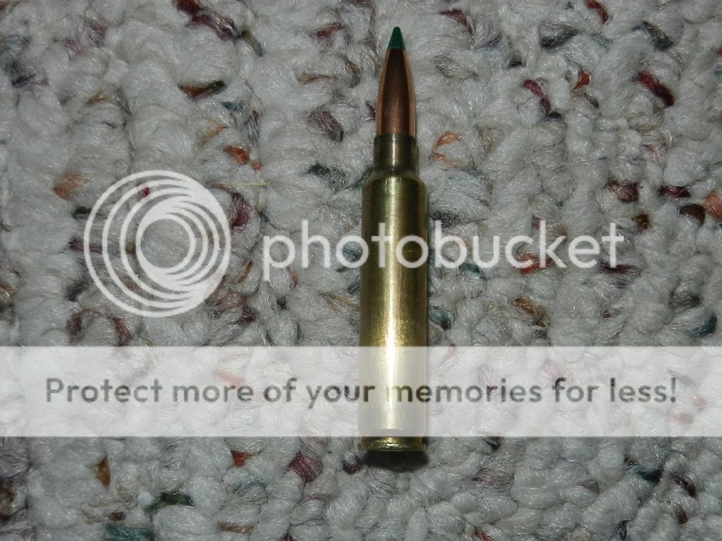

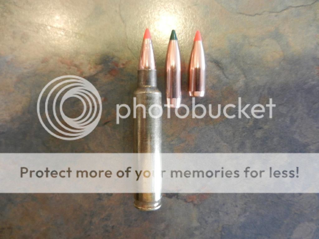

Lovin' the 69. Very 1st coyote this season was at 350ish, and it didn't even get out of it's bed. Meat report at 3075 mv was impressive. Next dog below that was at 150ish and had a quarter-sized exit wound typical of several others I've had at the closer ranges. Displayed violent expansion on a 250-yd. jackrabbit--
Here next to the 53 V-Max-
Here seated to VLD magazine length of ~2.460"
