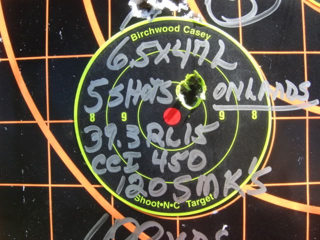

Below is my load, second target from the left.
Give Eric's load a chance, it may work in yours also.
Work up to this load, amazing what a few grains of powder will do to a pattern
Nice group! I've been using RL-15 also w/ the 123 SMK's @ the lands. I struggled 'til I switched to BR-4's (from 205m's). Neither Varget or 4350 worked for me. I've got a box of the 123 scenars, looks like it's time to try them. ;) Note: the 123 SMK varied up to .012" OTB box to box but properly sorted the rifle didn't seem to notice. Note 2: I couldn't get near 39 grns RL-15 w/o sticky bolt lift. Again nice group!
Every gun is different. I have no pressure signs or anything shooting the 120 smk's shooting 39.3 grns of RL15.
