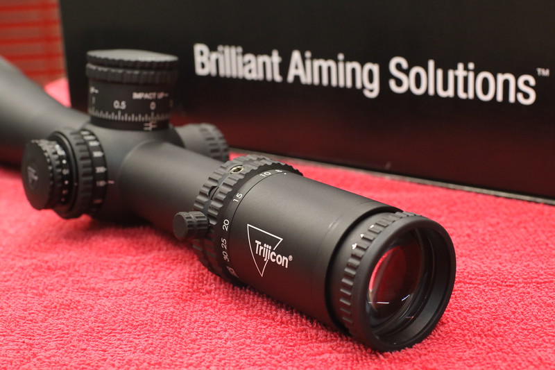

All the controls are clearly and logically marked, function of the diopter, magnification, and parallax dials is smooth yet secure.

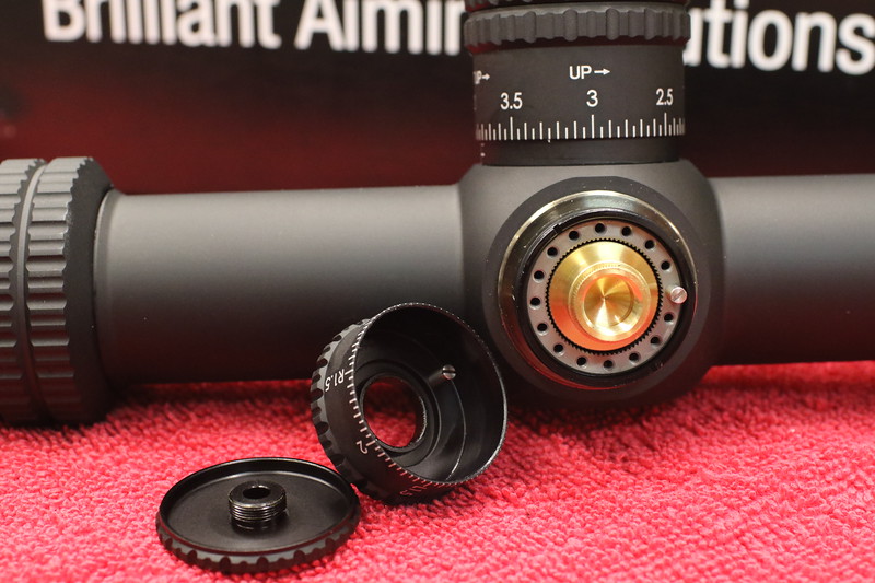

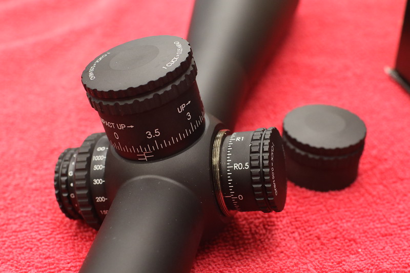

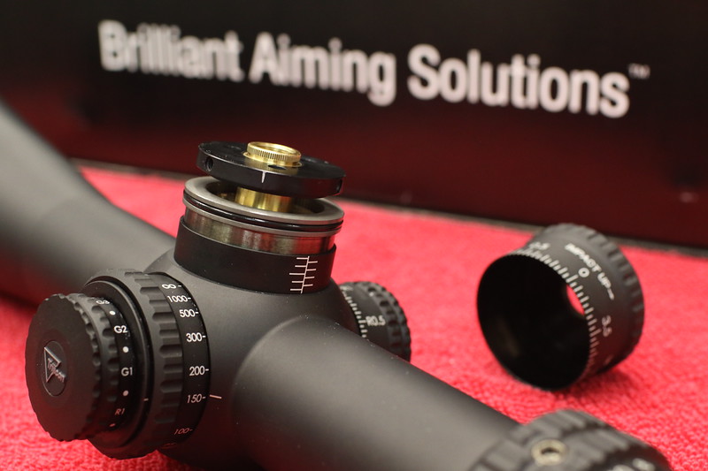

I really like the turret design and feel. All the machining very high quality. Very quick and easy to set zero and no tools required. The zero stop is very simple, loosen 3 allen set screws and let the collar drop and tighten the screws. The turret clicks are quiet and positive. The parallax has a wide ratio so it's not overly sensitive and the yardage was spot on at 50.
The capped windage turret is clearly marked for right and left input.
With the windage cap removed the turret looks like a typical tactical turret. I wasn't sure if I liked the capped feature at first but the more I think about it the more I like it. Wind is always a fluctuating variable and once I have a solid zero I always rely on hold-offs so having it securely covered makes sense to me.

Trijicon lists it at 38.4oz. The weight is similar to the Athlon Eres ETR 4.5-30x56 it replaced...… though my Vudoo V-22 is a tank at 13+ pounds so a few ounces difference isn't noticeable. I will say that for a 5-50x scope the overall scale is compact IMO.
