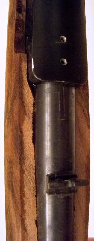

This one was a "pretty good fit" compared to some of the others that I've recieved. They might need to take a few lessons in tool sharpening or the use of a chain saw as well as inletting for a action ? ;) Just know going in what you "might" get.

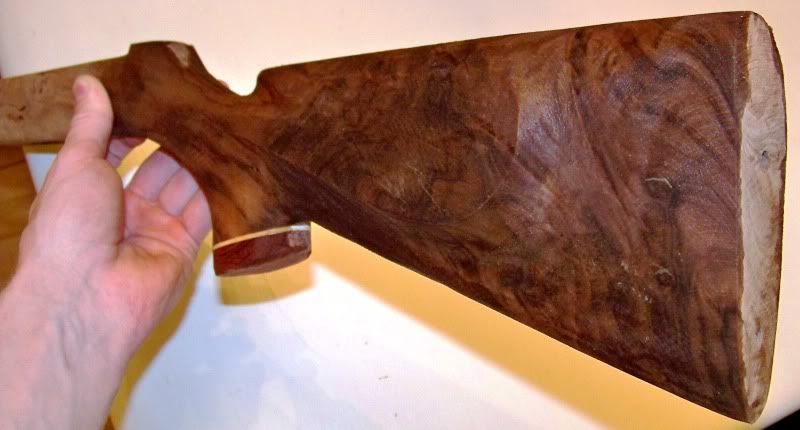

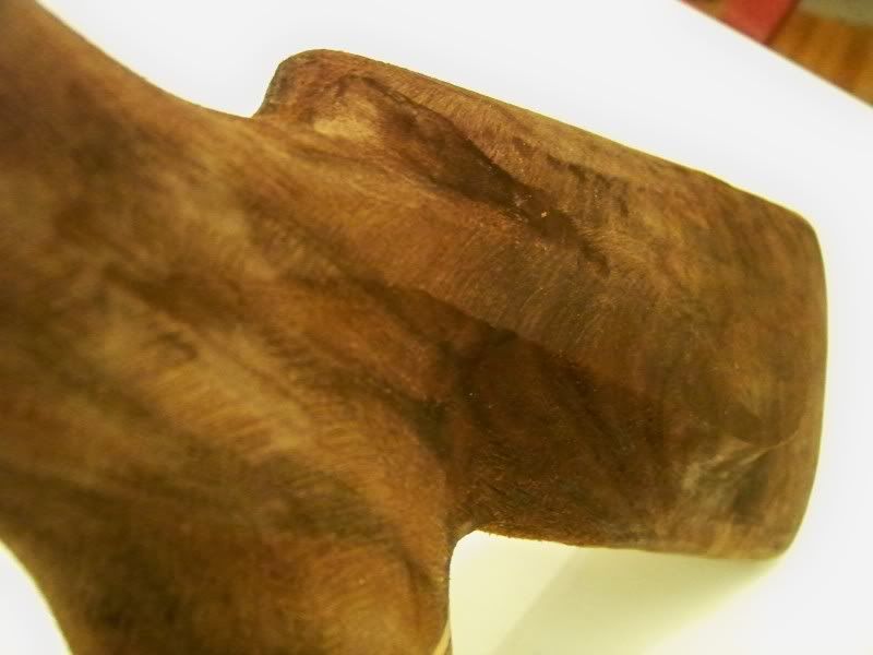

I ordered a Richard's stock in January and just received it a couple weeks ago. Here's a few photos you may want to see:
(notice how uneven the butt is- fitting a checkered steel buttplate will be a challenge)
Inletting was perfect (except for the awkward hump in the back of the receiver), however it is a 10/22 stock and they make a ton of those. Otherwise, it's pretty rough. Worse than the other Richard's stock I've bought. Deep sanding gouges, chips along the cheekpiece, awful looking flutes along the grip, and a very crooked and uneven butt. Its redeeming value is the price- this was a factory second stock and despite the high grade wood, it wasn't very spendy ($150 shipped).
The other Richards stock I got required hours upon hours to make the inletting fit.
