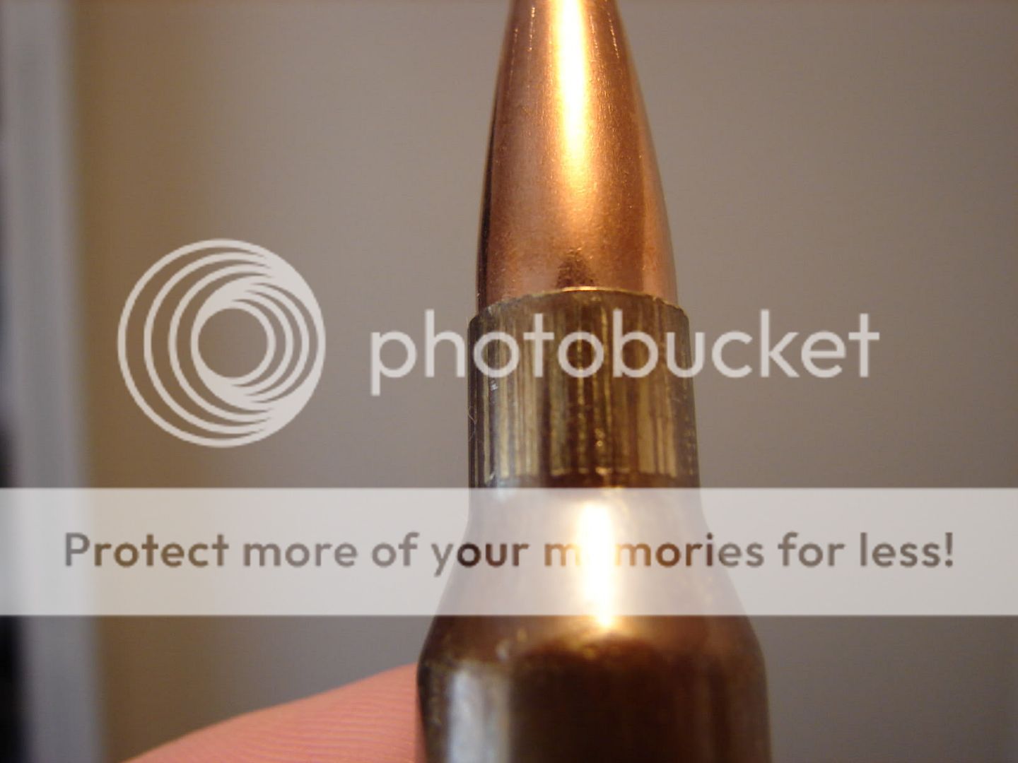

I fully prepped some fireformed Peterson brass for my 300 NMI. Worked hard to get my necks turned perfectly. While sizing in my custom Whidden die I noticed I was getting vertical scoring marks on my necks. I stopped, pulled bushing and cleaned it with 0000 steel wool in a drill, but I could still see the imperfections on the bushing. Checked the next bushing .001" smaller and the same thing. I need to get these replaced, but i cant remember if i ordered these from Whidden with the die or not... I have Redding, Wilson, and Whidden bushings for various rifles. The Redding bushings are stamped so those are easy to tell apart, but i cant remember how to tell Wilson and Whidden bushings apart??? Can you folks please help me identify if this bushing is a Wilson or Whidden? Thanks.

One of my turned and prepped necks BEFORE sizing
My neck AFTER sizing. Notice the vertical scoring marks. I can feel them with my finger nail :mad:

Again it looks like brass up and down streaks inside the bushing going across horizontal manufacturing marks.
So try removing the brass streaks with a good strong copper bore cleaner or polish with a bore mop.
The marks on your case necks are caused by brass rubbing on brass, this has happened to me before.
If you do not have a good powerful magnifying glass then take a closeup macro photo and enlarge it on your computer.
The up and down streaks were not done in bushing manufacture. The streaks were caused by brass sticking inside the bushing as the case neck was pushed through the bushing.
Below a Redding Titanium Nitride bushing leaving marks on case neck. Anytime brass sticks to the inside of the bushing it will score the neck. And it gets worse as more and more brass sticks to the bushing and with brass rubbing on brass. I have had the same thing happen with Titanium Nitride coated pistol dies like a carbide die. And also bushings and dies that were not polished correctly at the factory.
The same type marks can happen with a full length die if the neck shoulder junction of the die was not polished correctly and has a rough edge. Look at the case mouth below, the case was wet tumbled that left the case mouth peened over and not deburred properly. And the brass started sticking to the base of the bushing where the rub marks are more prominent and taper upward.
Below "YOUR" bushing and brass sticking inside the bushing. And these marks were not made during manufacturing of the bushing.
I cant even get those burrs off with a steel pick. First thing I did was hit it hard with a brush wrapped in steel wool on high speed in a drill and it did nothing.
Will give another shot with some heavy duty bore cleaner.
Still not right. Have never had other bushings do this to me.
On the photo of your case neck it shows both horizontal as well as vertical abrasion markings on the case neck. I am assuming the horizontal markings are from neck turning and the vertical is what you are expressing concern over. I have experienced somewhat of the same phenomenon. These "striations", if you will, have only appeared on brass sized with Redding "Nitride" bushings. I have Redding Nitride, Wilson "steel" and Whidden "steel" bushings. Why they have only appeared on the Nitride bushings escapes me. Having said that, I use the "Montana Extreme" nylon brushes and I take a drill and spin those brushes inside the bushing. Then I "wipe them clean" with a Q-Tip and old rag I use to wipe lube off of cases. Once the inside diameter of the Nitride bushings are cleaned and somewhat "lubed", I start using them again. I can go several hundred rounds before that "process" needs to be re-used.. Apparently, the introduction of the Nitride on the bushings, instead of increasing their lubricity, evidently contracts some debris that causes those striations. That debris, whatever it is, can be removed using the method I described above. It does work for some time>>>>although I am in the process of changing all my bushing over to either Wilson or Whidden.. There is less trouble.. I hope this helps..
